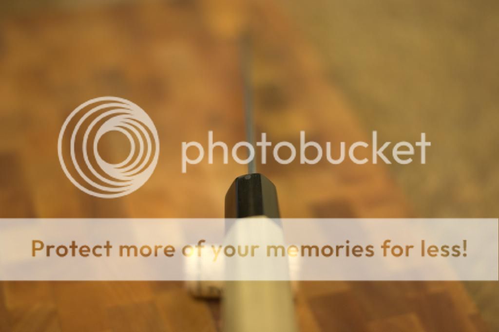

The knife has good fit and finish. The knife has a subtle visible cladding line. Kanji is deeply engraved on both sides, five characters on the right side and two small ones on the left. The handle is a basic light wood handle, dark ferrule with clean lines and a solid, no gap install, though the handle is rotated ~5° counterclockwise from square. The handle orientation probably would have gone unnoticed as it does not bother me but it had been mentioned by previous reviewers in the pass-around. The spine has a uniform, well finished radius along its entire length. The choil is also eased though the grind here is less finished and somewhat irregular. While the choil area is not uncomfortable for me as a home user, in time I might prefer to clean the area up more thoroughly.

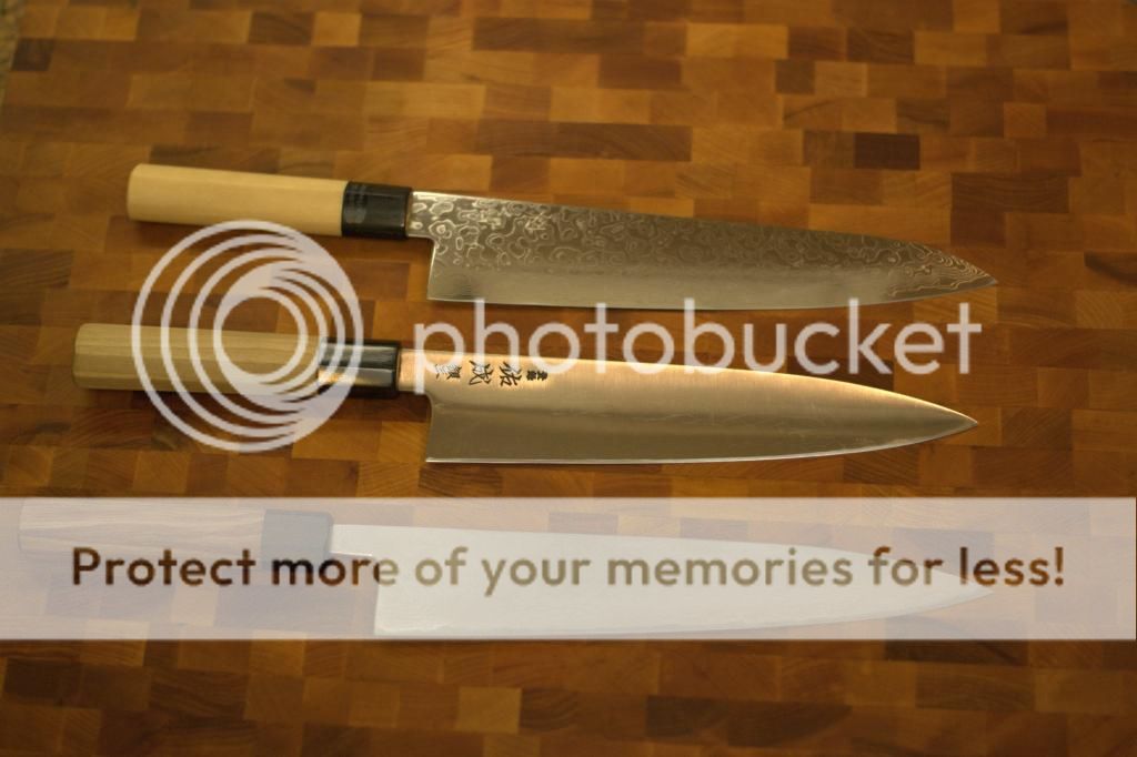

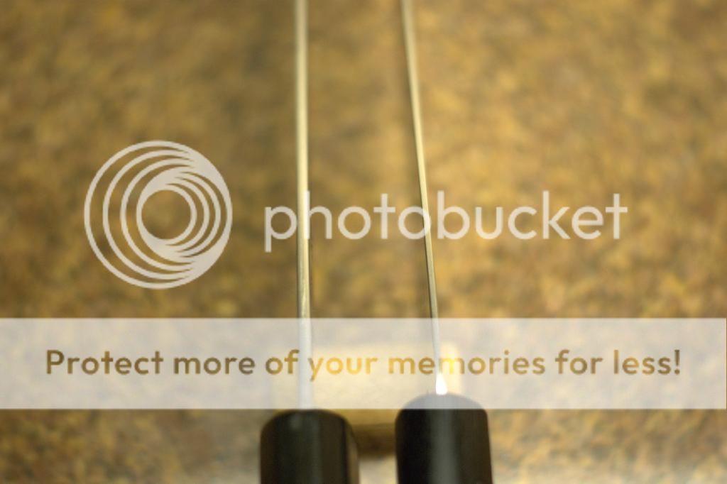

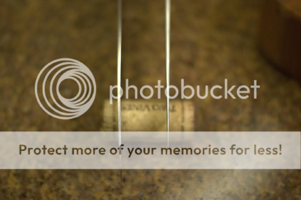

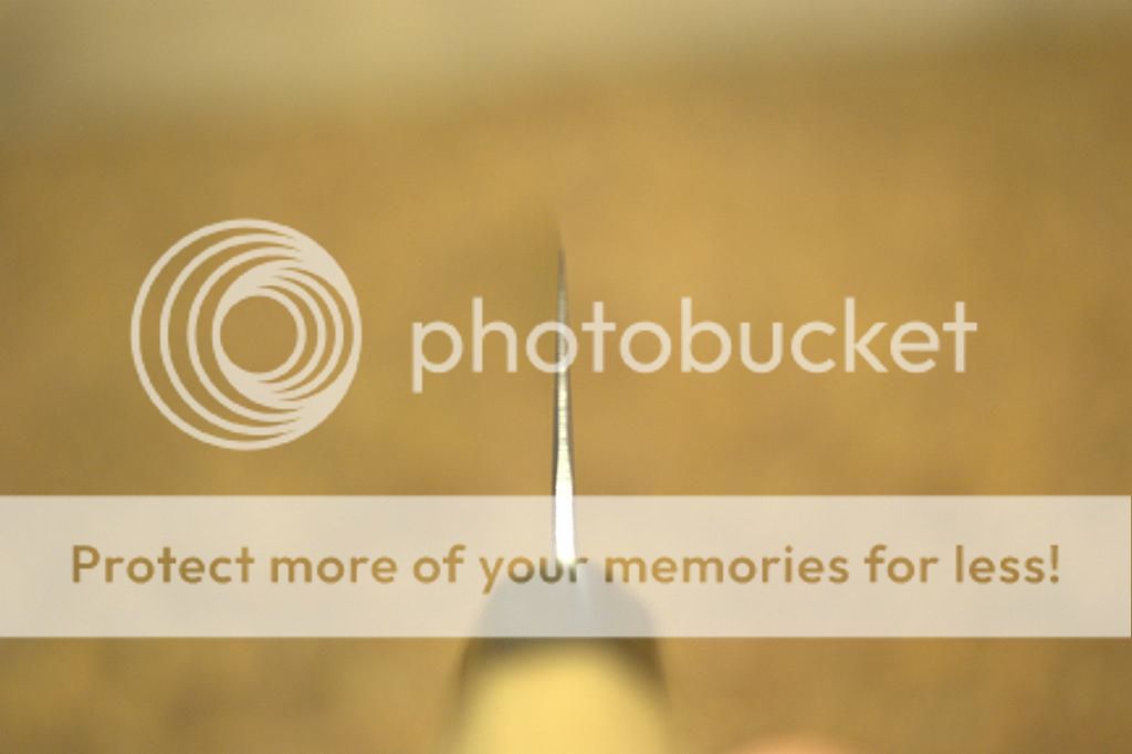

Pictures with a Goko Damascus and Ikeda for comparison. I apologize for being the photographer I am :roll:.
Choil
Sukenari left, Goko Damascus right
Goko left, Sukenari right
Handle install
