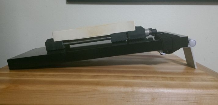

Ah - here it is :) I made this for one of Mark's first customers. I'll bet Mark would remember him ...
