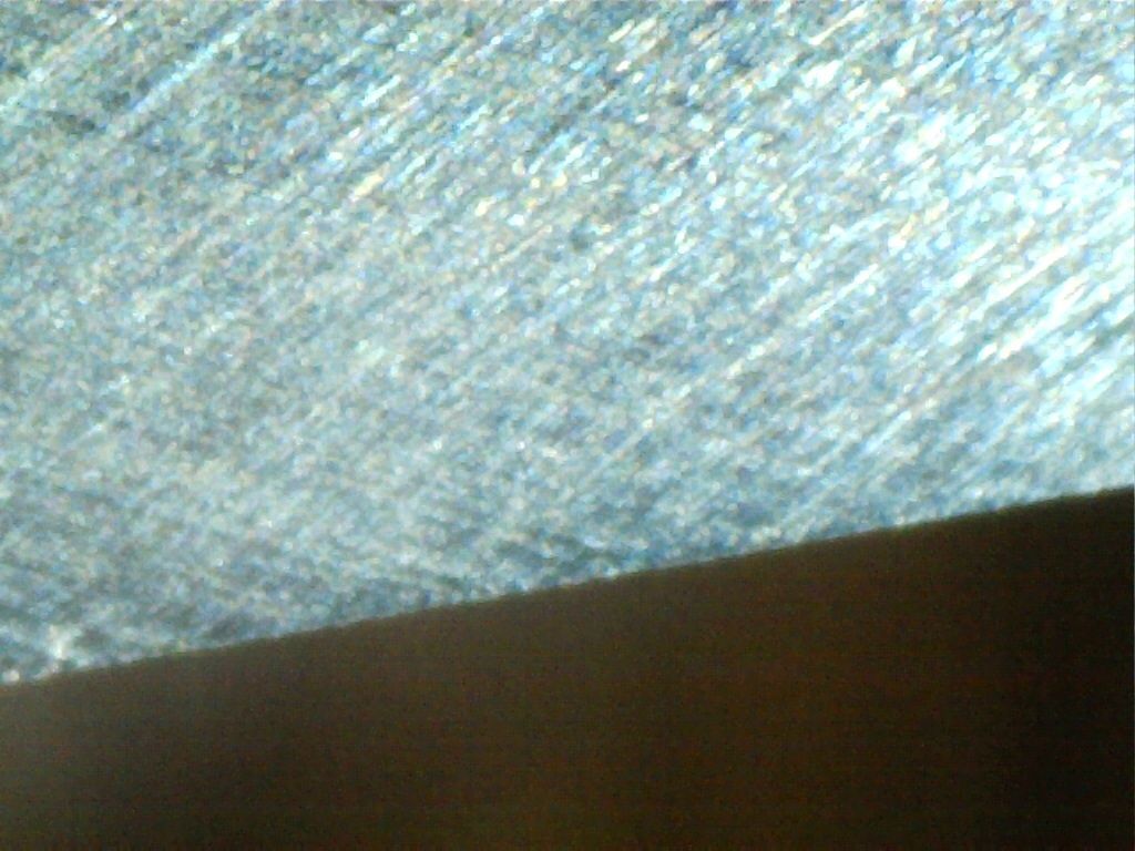

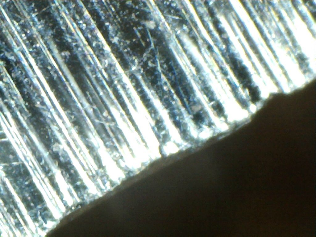

Here is a micrograph of a knife transformed by using bamboo 150, latte 400, green brick progression followed by 4 light passes on balsa loaded with .5 chromium oxide to remove any remaining burr, not to highly polish.
Before: this is a customers (sorry it's a cutco) :)
After:

Oh Cutcos haha. Nice work. Were you changing stroke directions your last stone?
Ken Schwartz is my crack dealer.....
 Post subject: Re: Micrograph bamboo 150, latte, green brick progression
PostPosted: Mon Mar 31, 2014 9:56 am
Joined: Fri Mar 29, 2013 4:29 pm
Posts: 495
Yes, and no. Yes, you can see the cross hatch scratch pattern. This comes from my technique. I do a first pass in sections using finger pressure along the edge with the knife at an angle away from me. This is similar to how they show it in the korin videos. After I have completed this on both sides, I do the whole edge at once with sweeping strokes to blend it all together. I set the stone at an angle almost parallel to the counter edge. This gives the scratch pattern in the other direction. The sweeping strokes are done with lighter pressure, but done long enough to get an even bevel all the way and complete. I don't know if this is the very best way to do it, it's just how my technique has evolved and what motions seem the most natural to me at the moment. I've been doing it like this for quite some time, but I am constantly learning and trying new things.
