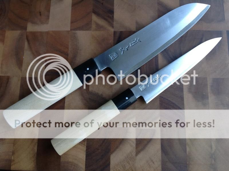

ang wrote:"Melampus: The knives are double edged, combination of stainless over carbon steel."
ANNIE <> If it's not too much I ask of you, I, & others I'm sure, would love to see a close up photo of one of the blades as I, for one, have never seen a stainless laminated Aritsugu before.
Embracing the silence amid a life and land full of static...
 Post subject: Re: Medium grit stone for my new knife
PostPosted: Sat Oct 26, 2013 7:17 am
Joined: Wed Oct 23, 2013 8:46 pm
Posts: 2
Here's a photo of the Wagokoro Santoku and Petty knives from Aritsugu.
